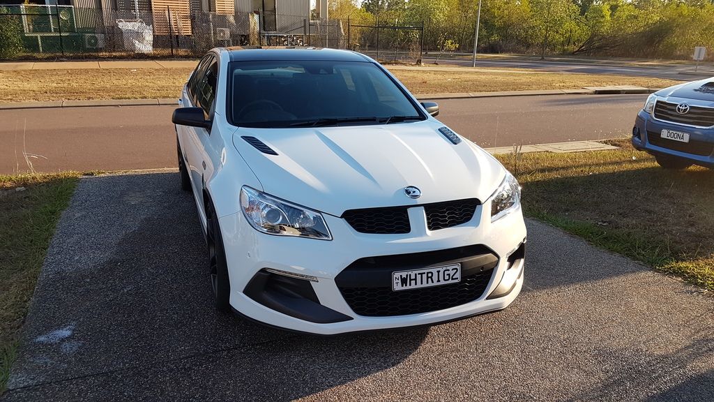

    Another vote for ceramic coatings for me.
    I had Gtechniq products used on my car; Crystal Serum Ultra being the main one.
    It cost a bit, however the car came up great and is really easy to clean. Most dirt/marks just fall off it with the pressure washer and there's very little actual rubbing with a wash mit required (if at all).
    I also had my wheels and brake calipers coated and they're also a lot easier to keep clean than I expected.
    I generally wash my car once to twice a fortnight. Process as follows (usually over a beer or two on a Sunday afternoon).
    1. Spray with pressure washer to get rid of most dirt.
    2. Use foam cannon and let foam sit for about half a beer.
    3. Rinse off with pressure washer.
    4. Use 2 bucket method and wash mit to gently wash (basically just let the mit glide over the paint with little to no pressure). Rinsing off panels as I go with the pressure washer.
    5. Head to fridge and grab another beer.
    6. Use a microfiber cloth, wheel woolies and the 2 bucket method to wash wheels, calipers and lower parts of the car (skirts, lower bumpers, exhaust tips, etc). Rinsing off with pressure washer as I go.
    7. Finally I have a couple of microfiber cloths I use to dry off, and lately with Gtechniq quick detailer which seems to work well and leaves the car silky smooth and looking great.
    Anyway, car looks better than new and I couldn't be happier.
    Only thing extra I'd like to do is start using some sort of tyre shine/cleaner product.
    Cheers
    Benno

    Car looks fantastic man.
    Nice and easy wash method mate, one thing I would definitely suggest is to clean your wheels and tyres before the rest of the car. If you clean them after you've washed your paint and dried it, dirt and debris from your wheels and wheel brushes will go straight back onto your fresh paint that you've spent ages cleaning; I've put a full wheel and tyre detail up in this section, have a read when you get the chance. Once your wheels and tyres are fully clean, do your same wash method to your paint then dry it, apply your paint protection, clean your glass, and then at the end finish off your wheels and tyres with paint protection and tyre shine.
    You can't go past Carpro PERL for a tyre/trim shine man, I think it's the best. Go and grab some Meguire's foam applicators from Supercheap to apply it with. IMO a car isn't complete until the tyres and wheels are protected and looking as good as the paint .
