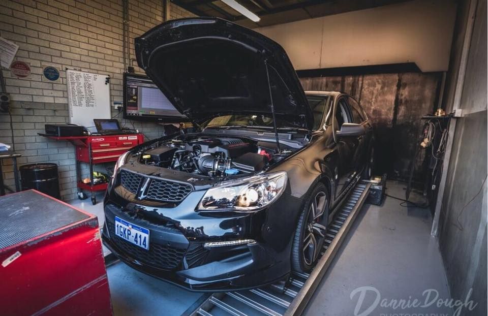

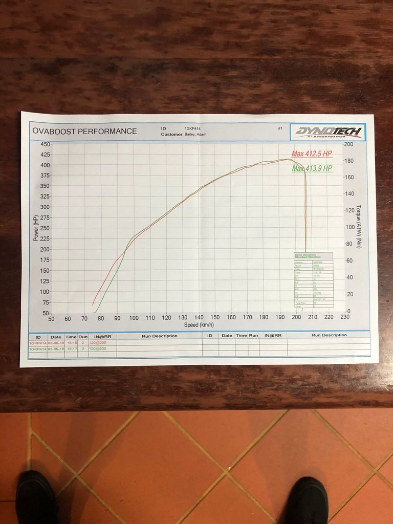

    Update on the car, a few weeks ago a couple mates and I went to a dyno day at Ovaboost Performance here in Malaga, W.A. Decided to put my name down to get a number on a sheet, cant go wrong with $60. It was a nice cool day, perfect for the LSA. There were quite a few good cars (all mostly stock), off the top of my head a C63 which I must say had the loudest exhaust I've ever heard and made 440 odd rwhp, a stock '15 mustang gt which made 298rwhp is about all I can remember. There was a big turn out of cars, some were heavily modified which would've been cool to see on the dyno but I believe a lot of people had problems with them and didnt want to risk running it, or were just happy doing a show'n'shine.
    Not bad at all for a stock auto LSA, I was thinking I'd see around the 400 mark. The best bit was, as it was the only one there everyone was frotttttttthing when the car came up which was nice to see
