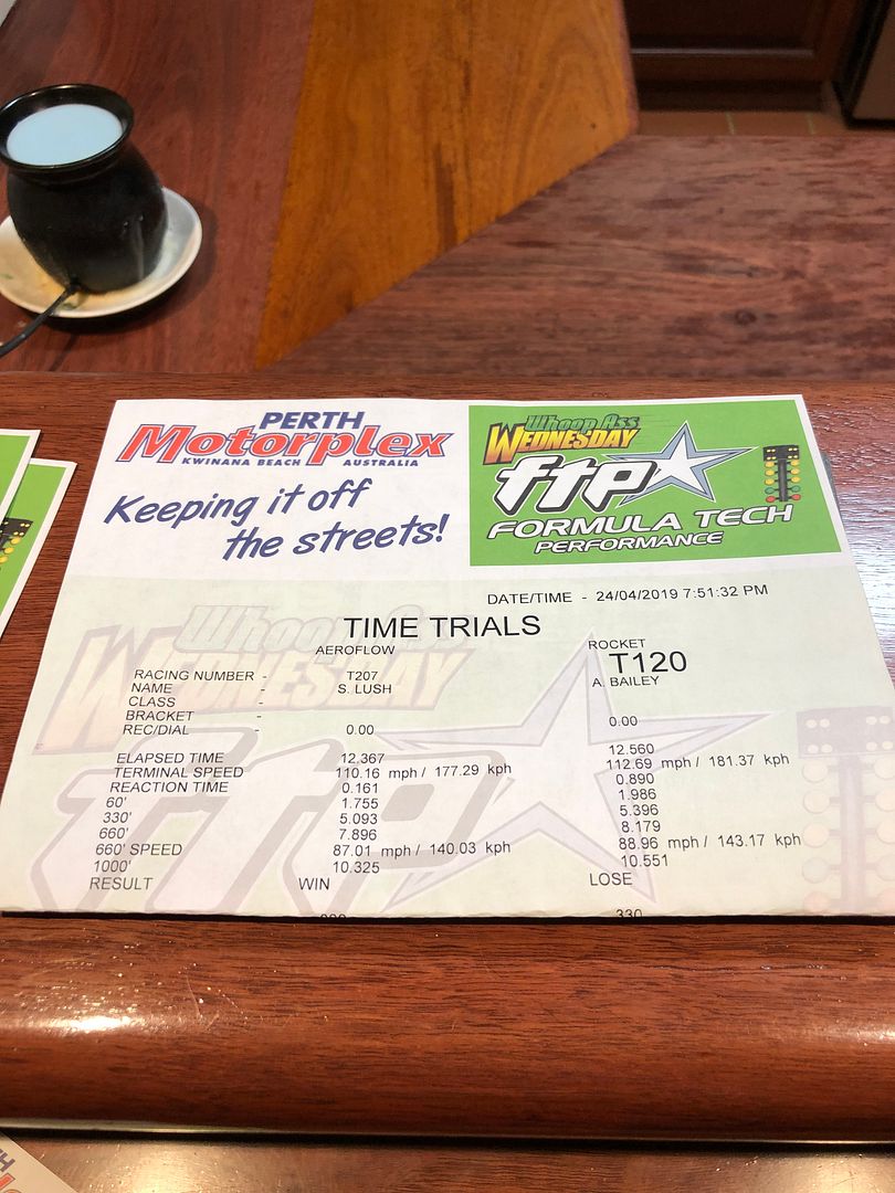

    I unfortunately never got around to going to the Plex in stock form, but I did go to last week's WAW with the current setup. I went there as the car was, full tank of petrol, Pilot Super Sport in std size at 38psi, I just wanted to see what the car would run and get a baseline to improve against. I tried a few different methods to get it off the line but was just blowing tyres all day, regular Drive and sports shift with no traction control aid, regular Drive got off the line easier but wasn't very quick I think I did 13s+ at 110mph, with 2s 60' from memory. Sport shift at this power level in my view is where the quickest times are, but grip is the major issue at staging I did quite a few 14.5+ second pa sses all above 110mph but 2.3+ second 60'.
    I was about to pack it in and go home as I had to be up early for ANZAC day so I decided to do one last pa ss, in all honesty I had no idea about what to do for a burnout, less or more heat? 2nd, 3rd or into 4th gear? So as I was coming up to a burnout there was a VF GTS in front of me which was cammed and had exhaust etc. so well above my power level and he was running a std size street tyre so I watched what he was doing and he got well into 4th gear from what I heard, so I decided I'd do the same. Staged up the car but this time eased into the throttle, the car finally hooks up! Best pa ss of the night! (T120)
    That was my 6th ever pa ss at the drags, with a setup not ideal at all. My plan is to go again but this time drop the psi in my rears to 25psi or less and leave my house with 3/4 tank of fuel as all up I used about half a tank driving there and back home and racing, and I left the car running the wh ole time I was waiting to stage up so the chiller could do its thing. Using the comp solenoid for the chiller I was seeing about 13'C while idling, I saw a max of about 35'C odd from memory at the end of the track which is perfect for the untuned ECU. I'm not sure if my engine fans were coming on very frequently and I wasn't really worried anyway considering the temps, but next time I'll turn the solenoid on about 20 mins before I get to the plex. Ambient temp was 24'C.
    All in all it was an awesome night, the bug has definitely bitten and I can't wait to get out there again!
    Anyone running a std size street tyre, what is the best 60' time you've achieved at close to stock power level?

    Much stronger MPH than the previous runs. Get a tune in to it, even on standard boost will be a very different car..but a little more wouldn't hurt that's for sure

    Thanks mate, definitely getting the hang of it now I think! Hahaha yep Harrop airbox + plugs and a tune is next on the cards for power, I'm considering either 28 or 34% overdrive atm for boost. I said to myself I wouldn't upgrade the cam in this car as I can't be bothered with getting pulled over every time I take the car out but I am considering an LS9 cam with factory idle, then chuck the bi-modal fuse back in; although I may only do that if something happens to the valvetrain
