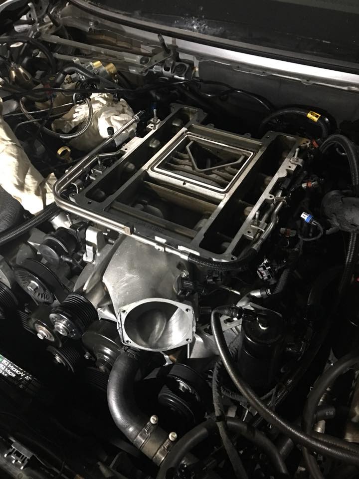

    This was a much bigger job than anticipated, my fabricator didn't like me much after doing this for me...LOL
    We had to make a new billet input shaft which was the most difficult part as the LPE one isn't as long as the LSA.
    Welding and grinding down to suit wasn't that bad but did take a while to build up and grind back down.
    Throttle body still sits in the same location, snout is closer to the throttle body which makes changing the belt a throttle body off situation, bit of a h***le but hey thats the price.
    Took these pics during install and cam swap.
