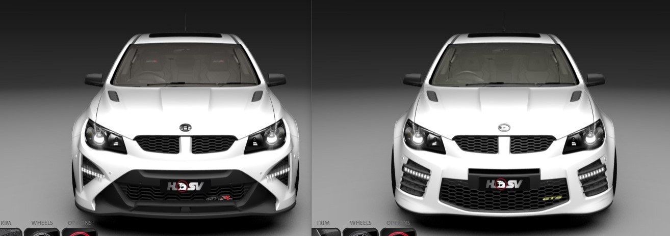

    Hi GenF-GTS,
    Would there be much difference in fitting the Interchiller to a GTSR vs GTS, front looks very similar and should be able to accommodate it?

    I do have a couple of pre orders in for W1's and GTSR's
    It will certainly fit I have discussed it with HSV and I don't foresee it being an issue.
