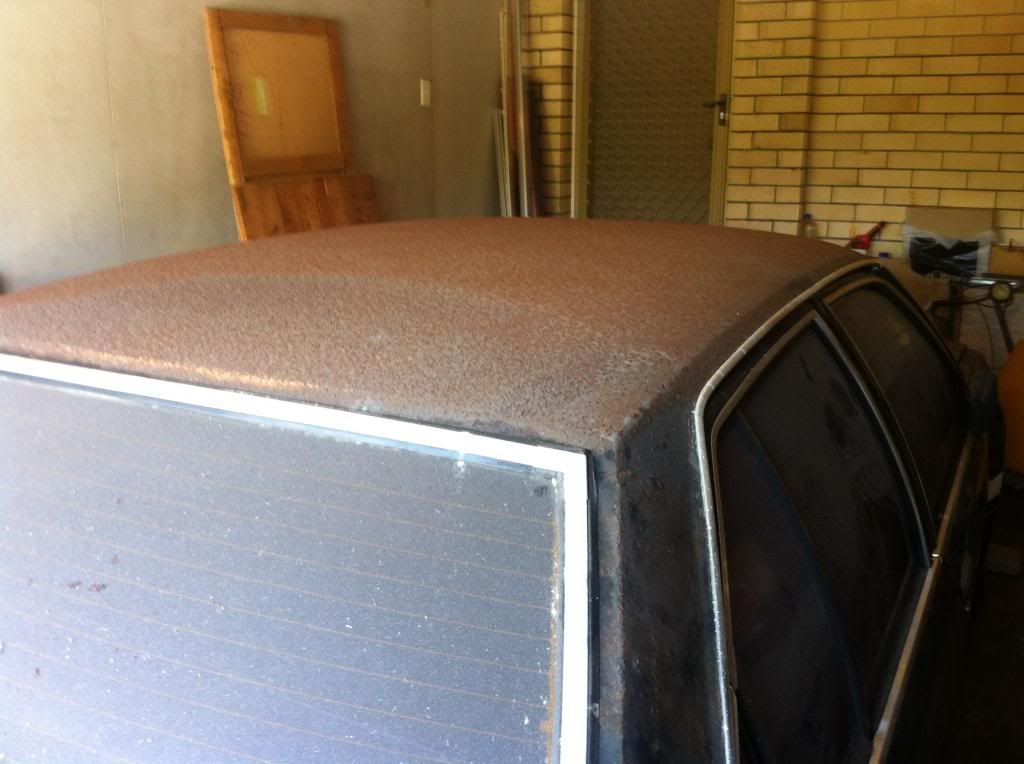

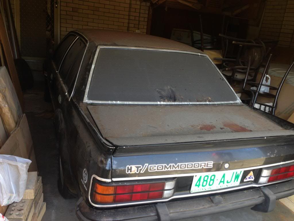

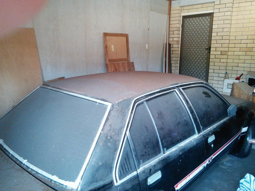

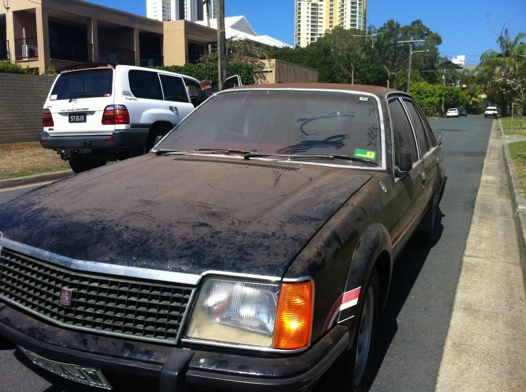

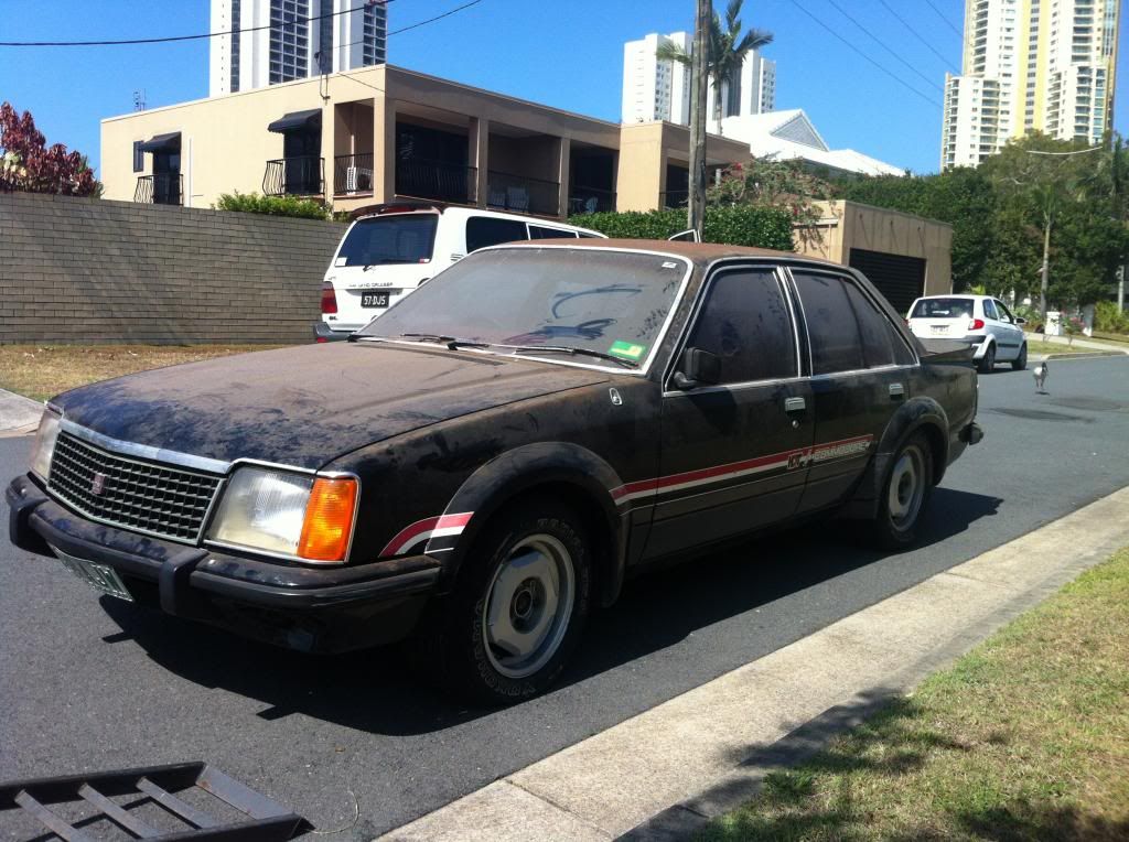

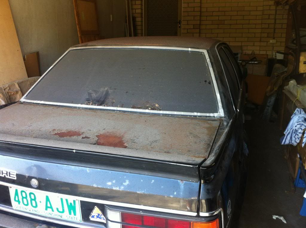

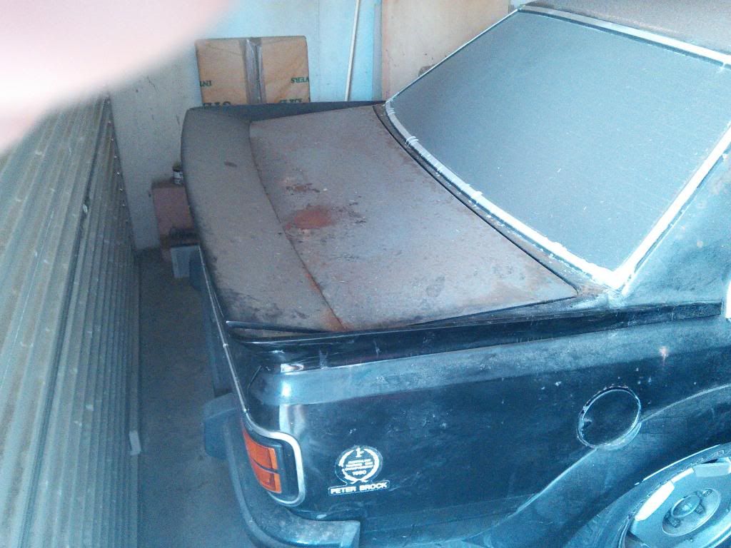

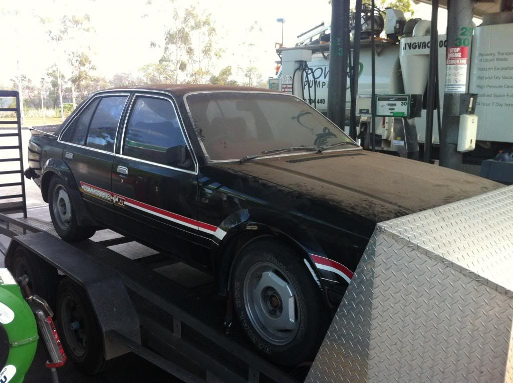

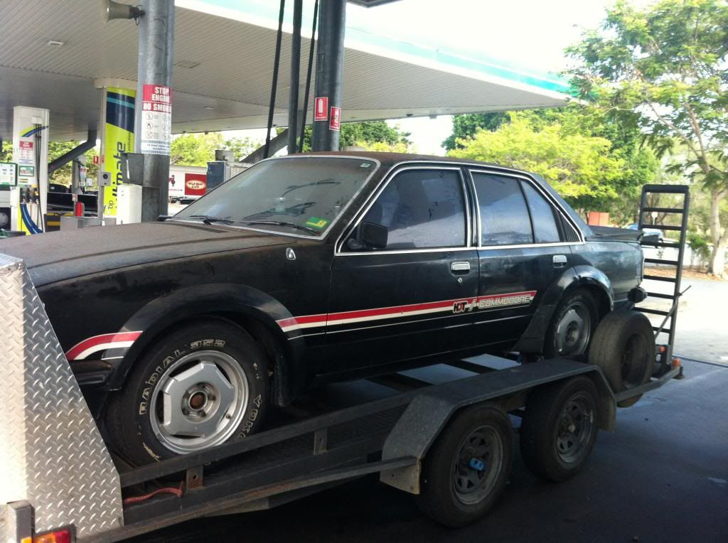

    Greeting us was a car that hadn't turned a wheel for about 10 years that had been in a garage un covered, that was near the beach on the Gold Coast. It was purchased by the owner in 1987 and due to health problems hadn't been used or started for around 10 years.
    Here are some photo's of how it was.

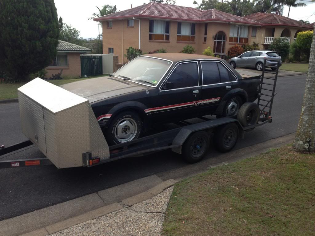

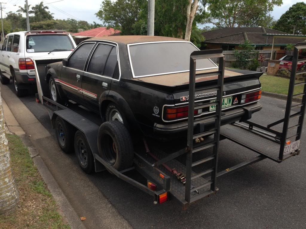

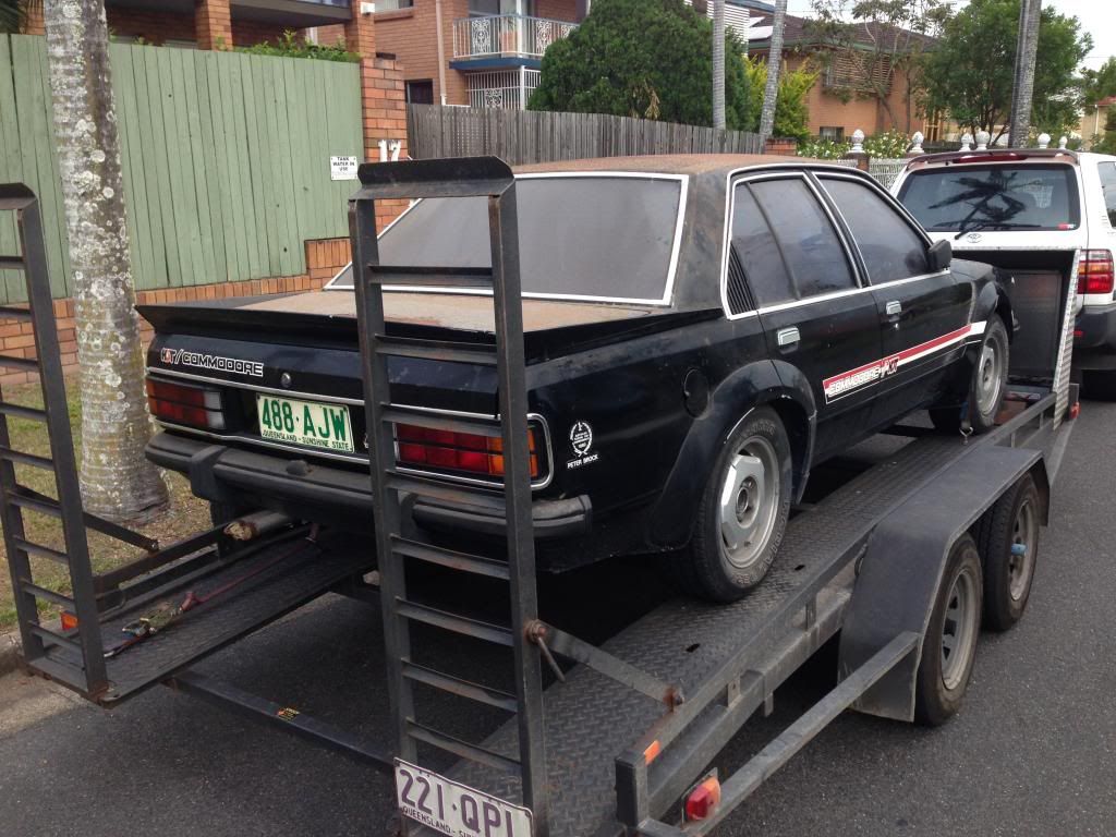

    After having a good look at it and seeing how big the job was we made a deal and the car left with us to under go a full resto a new home and to graze with some old friends.

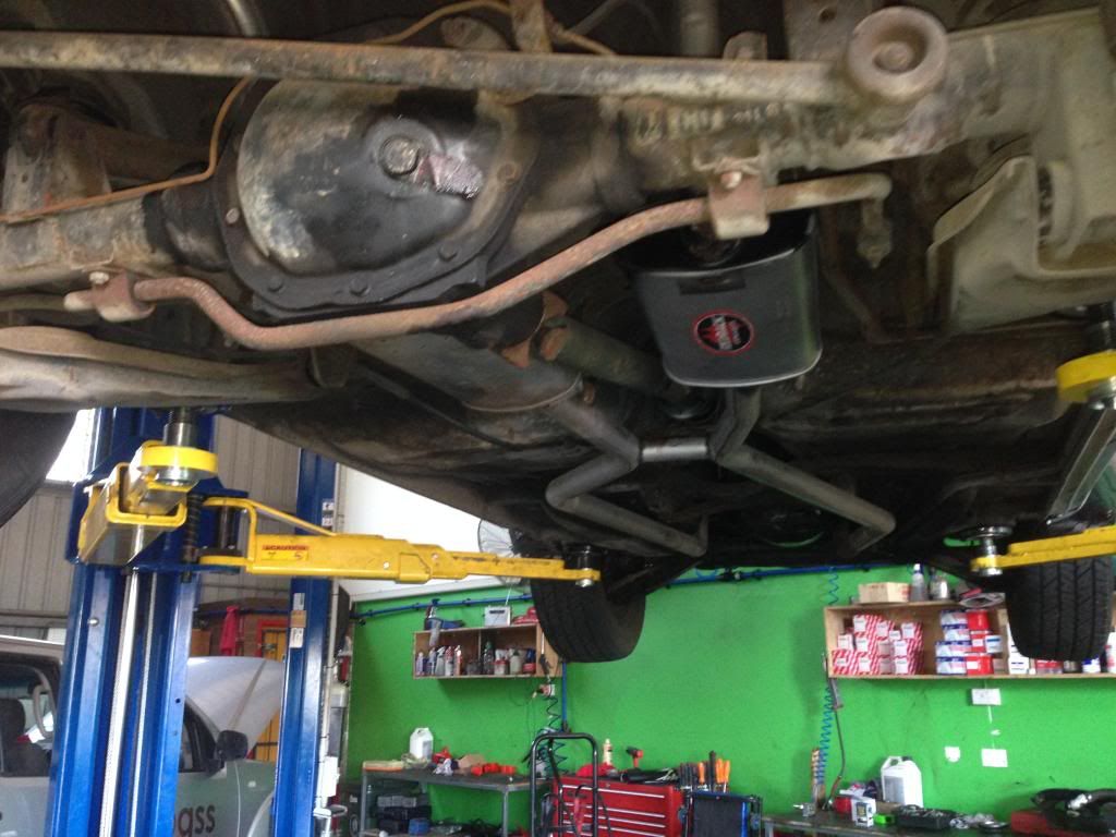

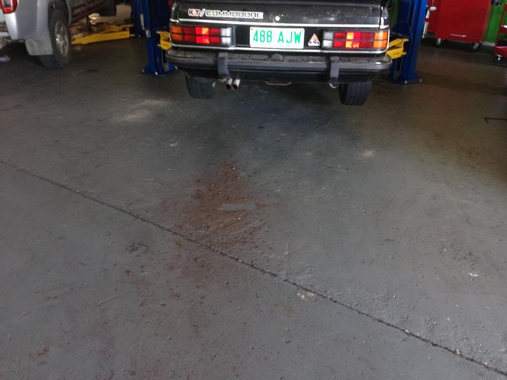

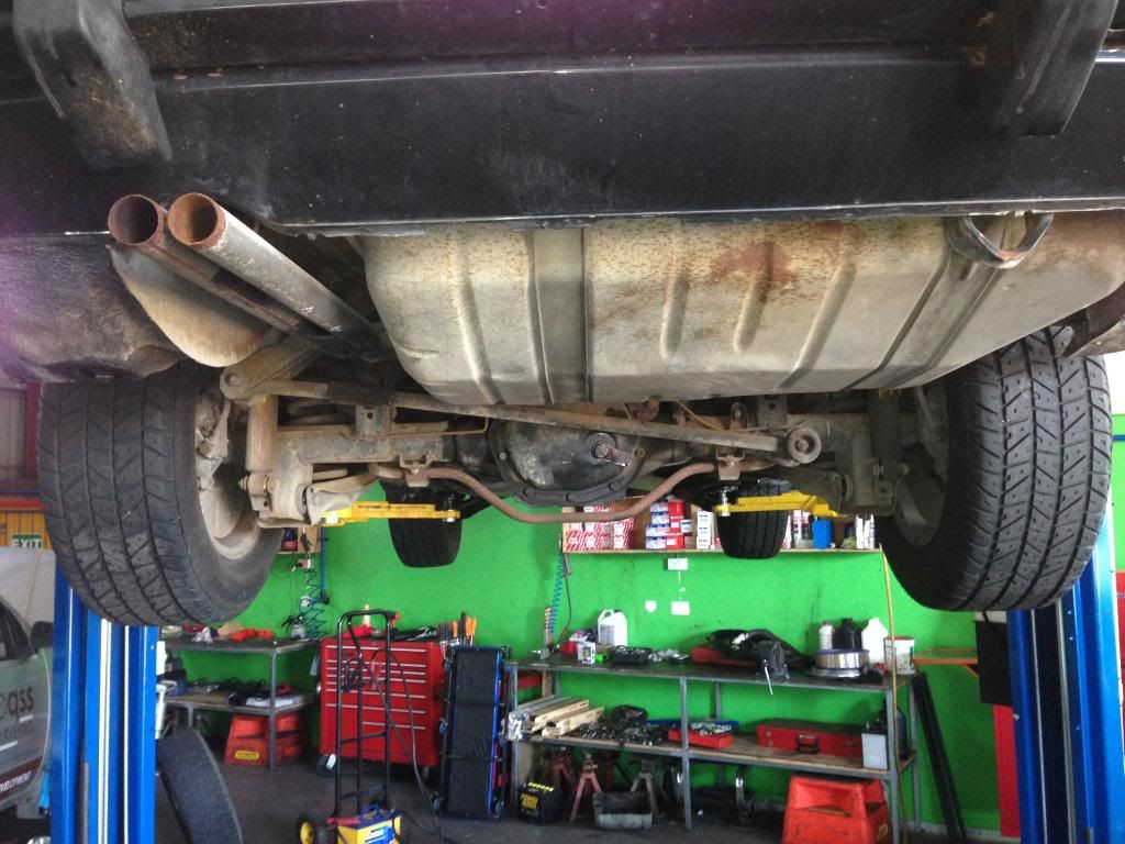

    After getting back to Brisbane I dropped it off to my mechanic late in the afternoon and I returned the next morning to check the under side of the car and see what other surprises where to come.
    Under enough the car it was pretty good considering, there was no structural rust but plenty of surface rust on the chrome work, exhaust and just about every other part.

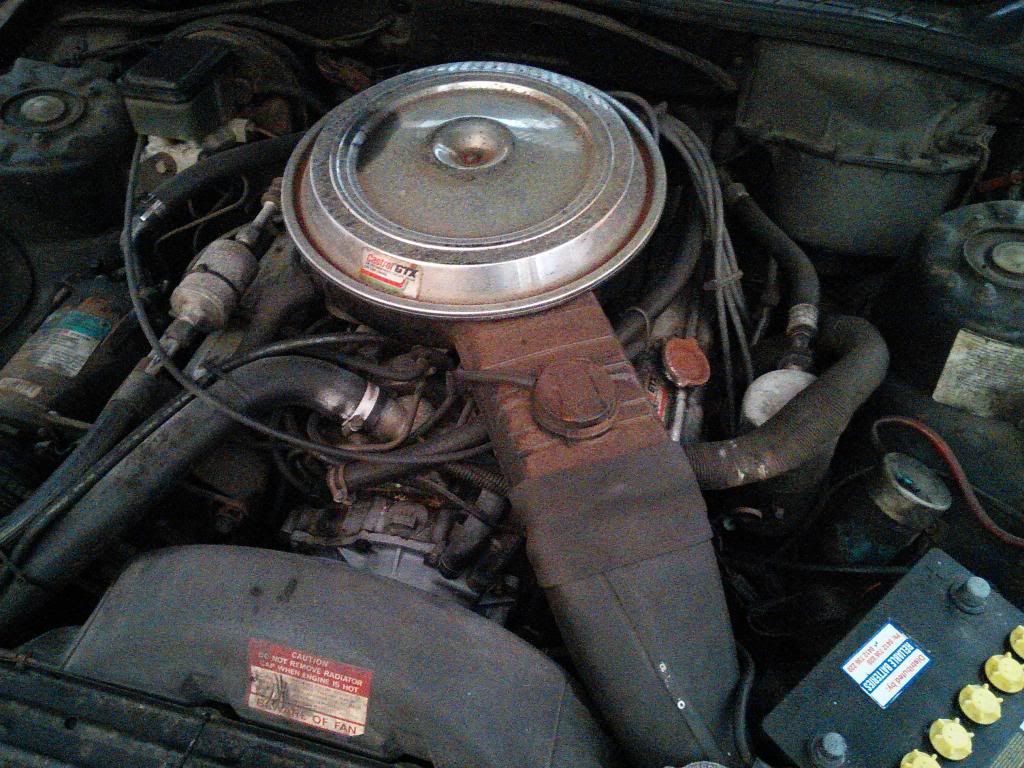

    The next thing I wanted to check was the engine, so out came the plugs and they looked really good so without plugs we where able to turn the motor over so we contacted a battery and turned it over on the starter motor and she sounded great and we got oil pressure on the gauze.
    So the plugs when back in and we fired it up on carby cleaner and she sounded sweet but it became clear the exhaust was not going to make it.

    Nice that's the only way to do it ...did you sandblast underneath also ????

    Underneath wasn't that bad, we didn't need to sand blast it, we just degreased it, pressure cleaned the hell out of it, cleaned it and painted it. There are more photo's to come.
